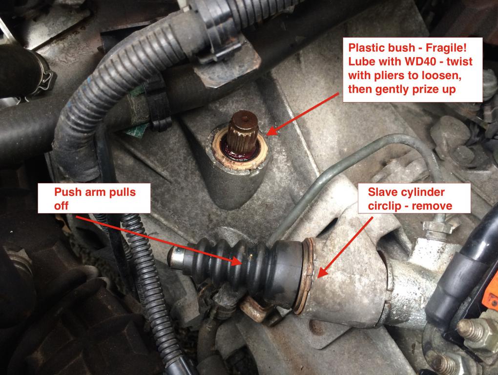

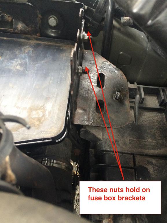

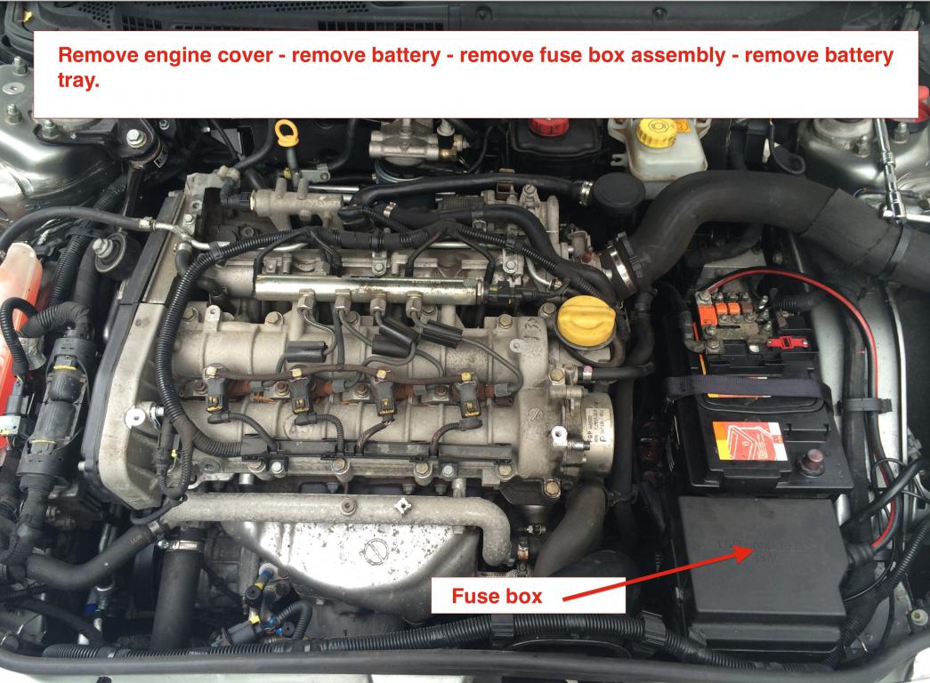

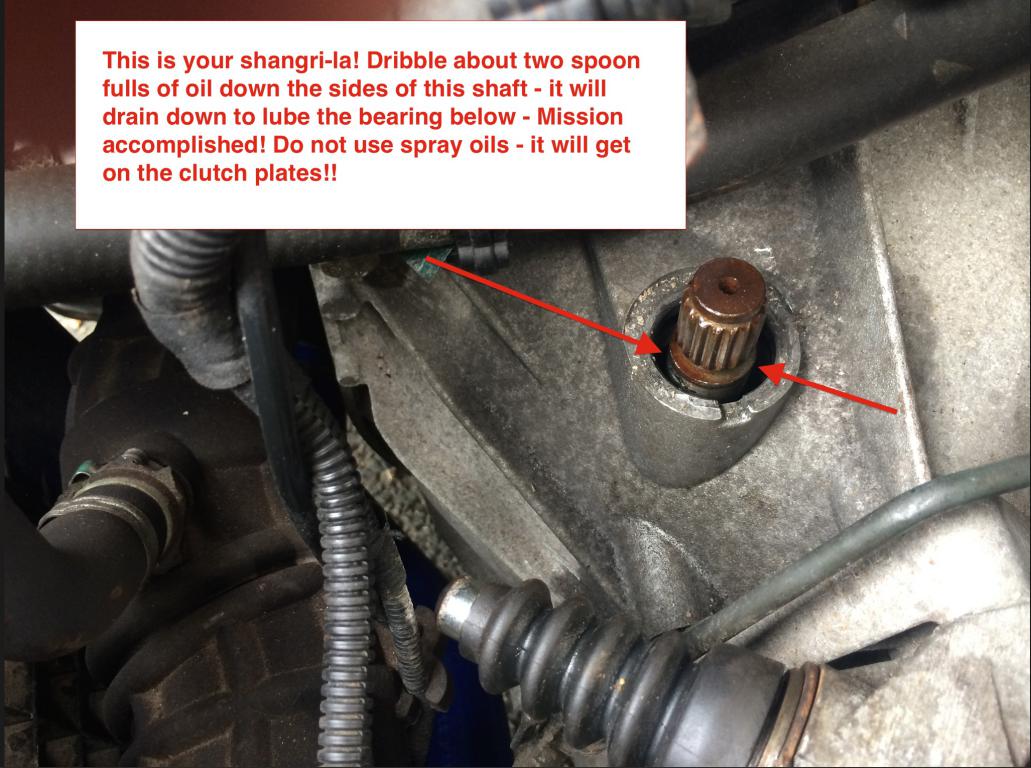

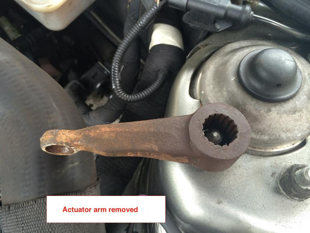

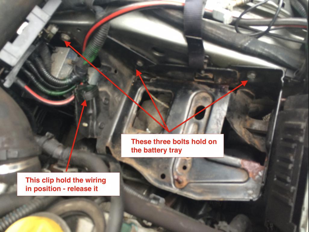

    kopia z alfaowner...

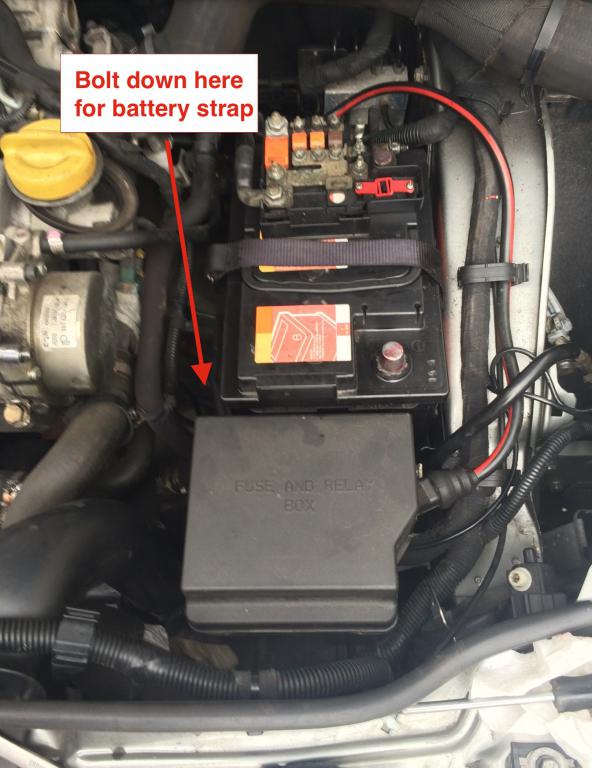

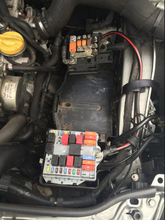

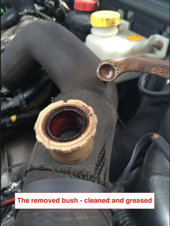

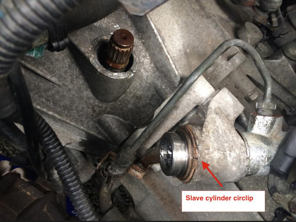

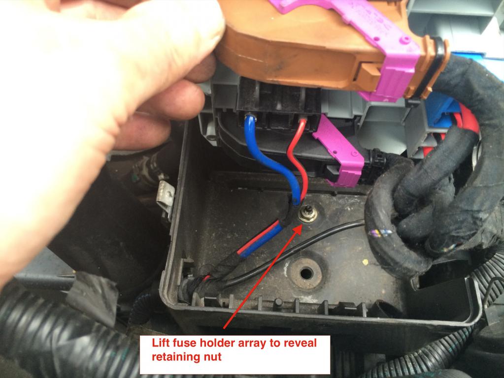

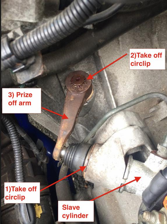

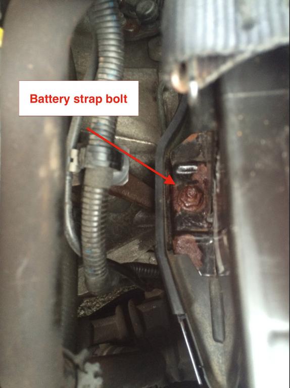

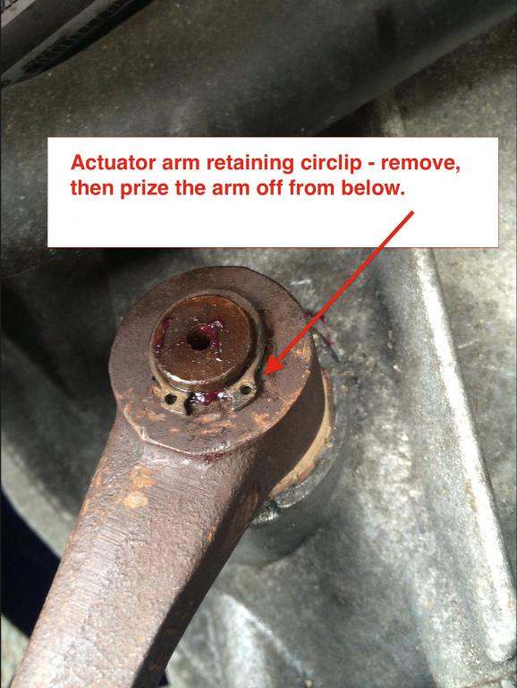

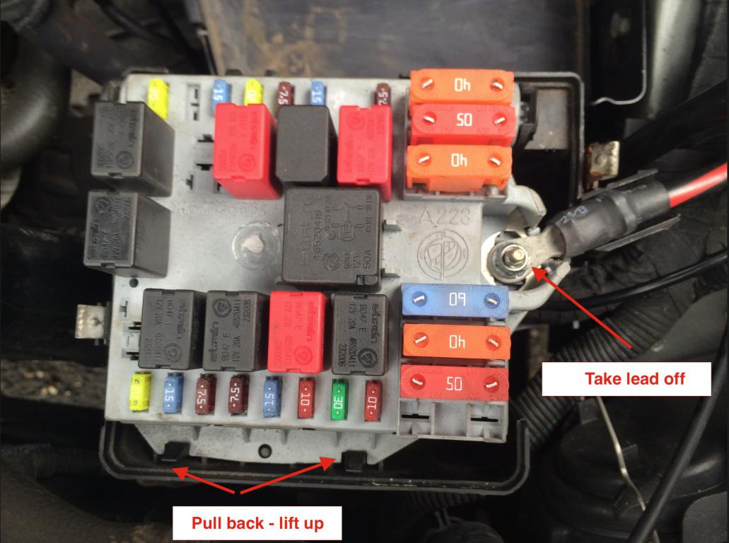

    1) Engine cover off
    2) Battery off
    3) Fuse box taken off battery
    tray
    4) Battery tray off - this reveals what your after - the clutch actuator
    arm.
    5) Remove slave cylinder circlip...push back slave cylinder, having
    taken the cap off
    the clutch fluid bottle first.
    6) Remove actuator arm
    circlip - spray area with WD40
    7) Prize off actuator arm from underneath. I
    used a hammer to 'tap' it up
    from below. When putting it back, it can only go
    back in one ( the right ) position.
    8) WD40 on plastic bush. Be careful here
    as it can be fragile and break, take your time to let the WD40 penetrate, then
    gently twist it back and
    forth with molegrips to get moving. Then use small
    screw driver to gently prize up and off. Clean and grease.
    9) Clutch
    shaft now revealed. Dribble about 2 table spoons of oil ( 3 in 1 will be OK ).
    This
    will drain down the shaft and lube the bearing below. Do NOT use a spray
    oil, as it will get
    on clutch plates causing them to slip. Leave for a few
    hours.
    10) Re-assemble
