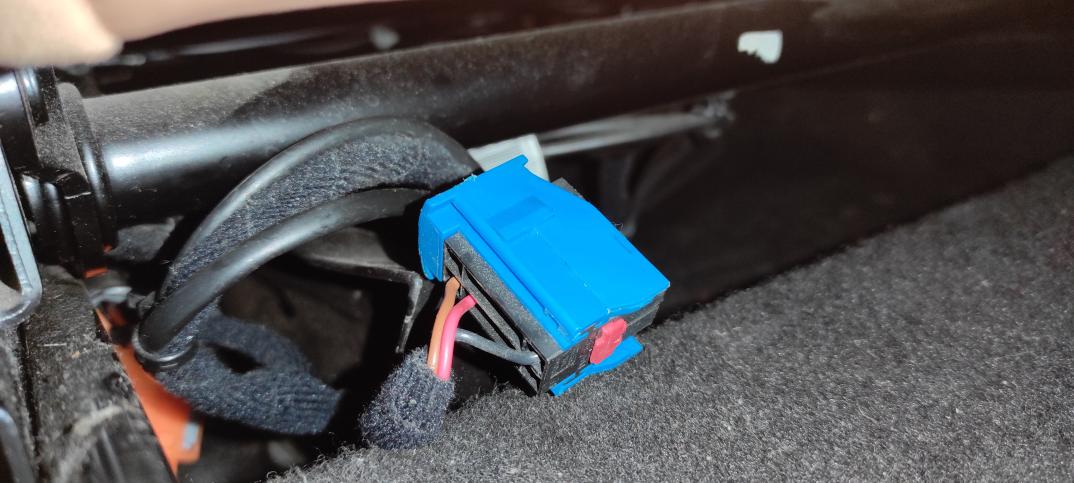

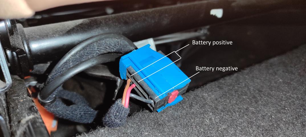

    Domyślnie [langtitle=hu]Alfa Romeo 159 SW 2009 Seat Heater[/langtitle]
    Hello all,
    I have a Alfa 159 and I bought a full wine interior. I didn't had heated seats before. Now it's mounted the new interior and I need to connect the heated seats. I doesn't have the wiring in the car.
    So firstly I want to connect directly to the battery the heater wires, to check if it's work or not. Can you help please how I can connect directly the wires to chek if it works or not the heating sistem?
    I have this connector see on the picture.
    (I think that the black is the negative, the red wire is for the switch light and the brown wiri is for the heater (pozitive)
    I tried to connect the battery negative to the black and the battery positive to the red and brown cable. The light on the switch it was turned on but no heating on the seats, I tried both sides but the same result no heating. (driver and passager side))
    So please let me know how I need to connect the wires.
    Thank you in advance!
    Gyarfas Attila
Nazwa:	1670761510474.jpg
Rozmiar:	78.4 KB

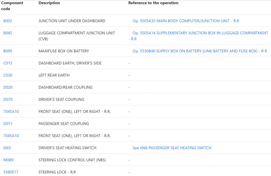

    Hello.
    Maybe this diagram will help you.
    https://4cardata.info/elearn/939/2/9...0000/939011648
Nazwa:	wiring1.jpg
Rozmiar:	75.9 KB
Nazwa:	wiring2.jpg
Rozmiar:	69.3 KB

    [lang=hu]So I have tried this connection, but the result it was that the switch light it's turned on but I staid 10 minutes in the seat and I didn't feel any heat. Picture below.Kliknij obrazek, aby uzyskać większą wersję
Rozmiar:	83.1 KB
    Do you have any observation about this? I tried ok to connect directly?
