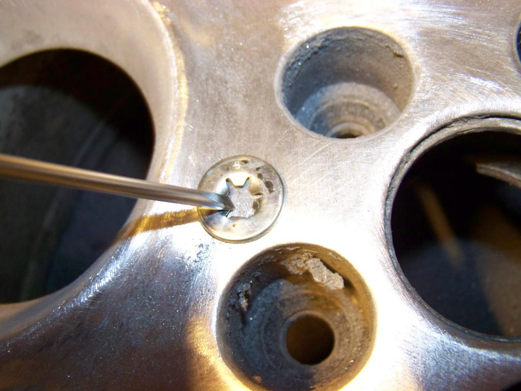

    I have just removed, and judge in the Kingdom so now I'll make You phot.

    Wginasz "mustache" inside (as I showed with a screwdriver), and again, and again descends. "Mustache" love to break.
