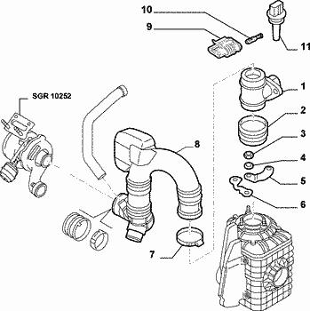

http://eper.fiatforum.com/eper/navi...6&WINDOW_ID=1&SGRP_COD=23&SGS_COD=3&DRW_NUM=3
interesuje cie to pod nr 1
