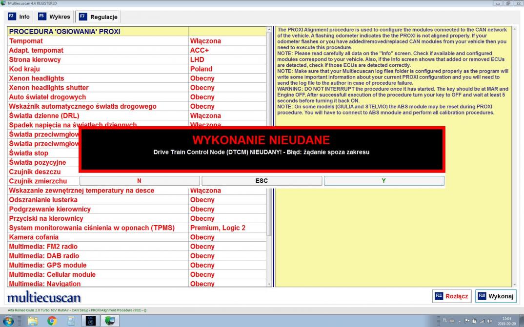

    Tu wklejam Kliknij obrazek, aby uzyskać większą wersję
Nazwa:	unnamed.jpg
Rozmiar:	135.9 KB

    Yani odpisał w sprawie błędu z race mode :
    The “out of range” error usually means that there is an option in PROXI which is not supported by the module or not compatible with it. This happens on some Giulia/Stelvio DTCM modules when you try to enable race mode. Unfortunately, we do not know the reason. It could be old firmware version of the DTCM that does not support sport mode. It could also be related to another PROXI option (activated in your proxi configuration) which is not compatible with sport mode.
    Wysłane z mojego SM-G973F przy użyciu Tapatalka
    Odpisał jak polityk.
