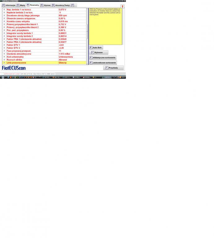

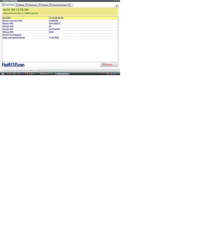

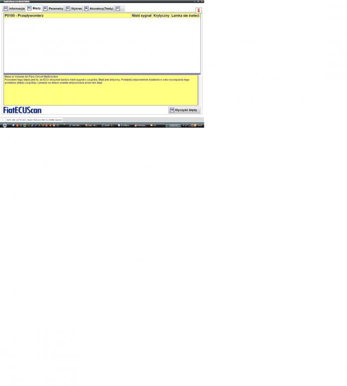

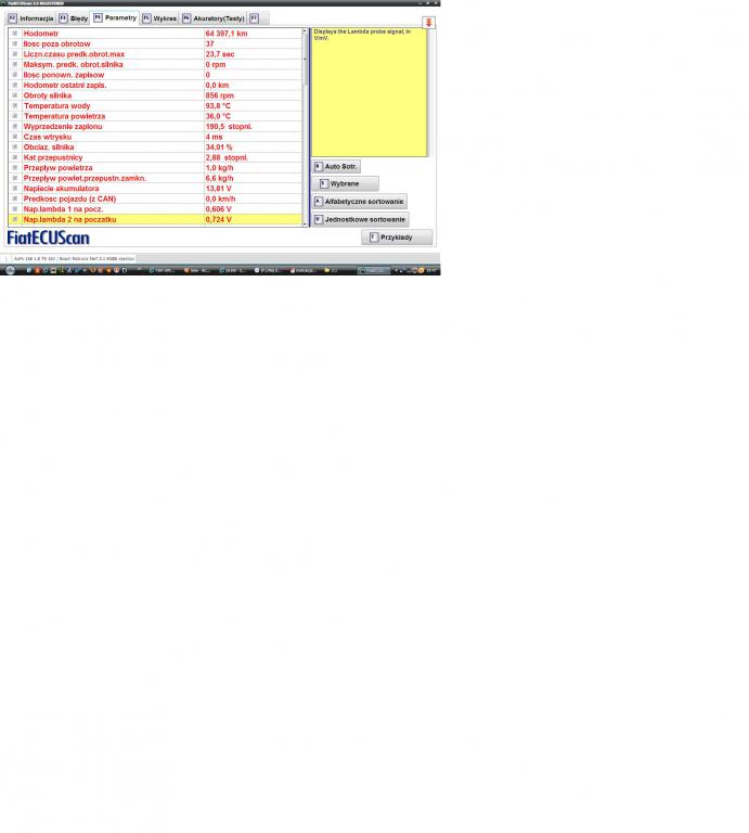

Niestety ale to nie pomogło. W AD pokazuje to:
Failed Component Code: Air Flow Meter
Fault Symptom: Below Minimum Limit
Warning Lamp Status: Warning Lamp Illuminated
Fault Test State: Test complete for this Error or not applicable.
Fault Code Storage State: Error Present at time of request
Event Count: 40 count
Environmental Condition One: Engine Speed: 1200 rpm
Environmental Condition Two: Relative Load: 50,25 %
Environmental Condition Three: Engine Coolant Temp: 28,5 °C
Environmental Condition Four: Air Temp: 24 °C
Environmental Condition Five: Throttle Valve Angle: 0 °
Environmental Condition Six: Battery Voltage: 14,03 volts
