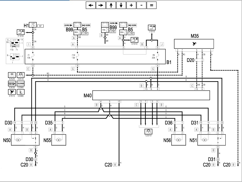

W eLearn szukałeś schematu?
nie mam elearn niestety ...
Schemat i opis (ale wersja przed FL to "może" będzie podobnie):
Załącznik 73980
B1 Junction unit 5505A B5 MAXI FUSE box-1 - B5 MAXI FUSE-1 box - B5 MAXIFUSE box-1 - B99 Maxifuse box on battery - B99 Maxifuse box on battery 5530B C20 Passenger side dashboard earth 5505A C31 Rear right earth 5505A D20 /Rear dashboard coupling - D20 Dashboard/rear connection - D30 Rear / front door connection left - D30 Rear / front door coupling left - D31 Coupling for rear/right front door - D31 Rear coupling / front right. door - D31 Right front door rear coupling/. - D35 Rear / rear door coupling left - D35 Rear/right door connection left - D36 Rear/right door connection door - D36 Rear/right door coupling right - H1 Ignition switch 5520A I50 Inertia switch 1040A I50 Inertial switch 1040A M35 Alarm remote control receiver 5580E M40 Integrated services control unit 5505A N50 Front door lock gear motor left 7005N N50 Right front door lock left 7005N N51 Right front door lock geared motor 7005N N51 Right front door lock motor 7005N N55 Left rear. door lock geared motor 7010N N55 Rear door lock geared motor left 7010N N56 Rear door lock geared motor right 7010N
