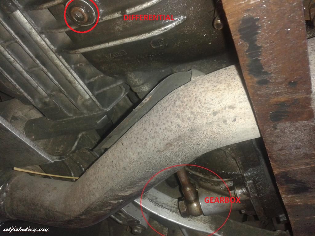

Hi,
I would like to change the oil from gearbox and differential.
Is it correct that is enough: unsrew the cap\screw from gearbox (hex female 12mm) not visible in the picture below and unscew only the banjo from gearbox? What is the other cap reported on differential?
Thank you,
ciaoZałącznik 257732[/lang]
[lang=it]Ciao,
nessuno?[/lang]
Hi
Yes. This pipe is a lowest point of the gearbox and differential. You don't need unscrew this screw on the diff.

[lang=it]Hi,thank you for your answer and sorry but I don't why, I didn't see it before…Is it enough to unscrew only the pipe on gearbox to drain also the oil inside differential? The other side of the pipe is very difficult to "unscrew" because there is the exhaust line...[/lang]
[lang=it]Hi,
to take the oil stick how you suggest to proceed?[/lang]
