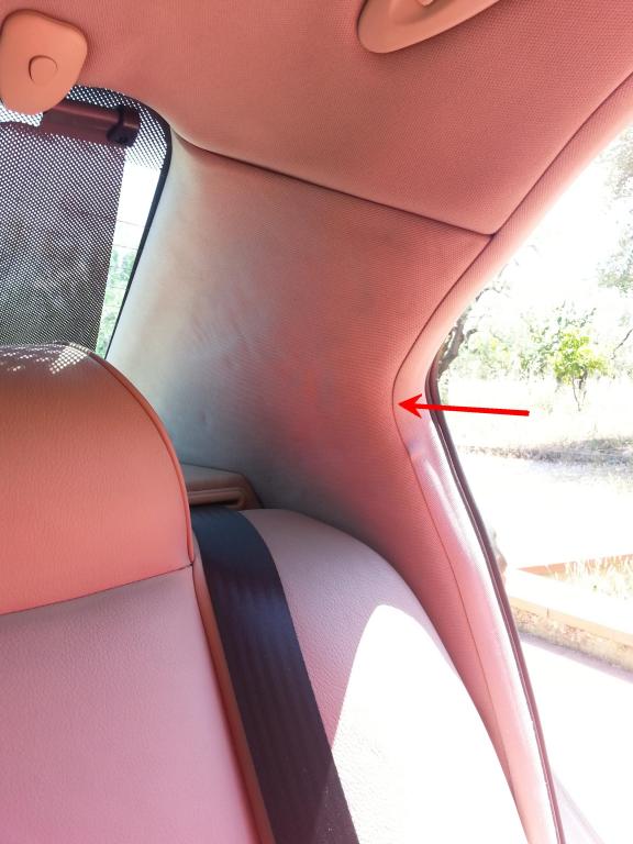

Perfect guys, I managed to remove the panels :) ... but now I do not understand how to insert the black bolt in the hole (red arrow) .... there is no space to be able to press on the bolt :unsure: Maybe I'm not sure!!

Ok I was mounted all over (the black bolts were easy to put on ... I thought the position was more awkward). But I have two rubber inserts, very difficult to position !!!
