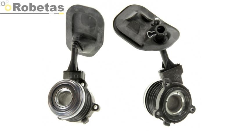

    Stock c510/c530 gearbox used mechanical central clutch bearing and external hydraulic clutch cylinder
    To use twin plate you must change that to central hydraulic clutch bearing.

    154
    Yes i know it, but i didnt know how to mount hydraulic clutch bearing on to c530 gearbox)))

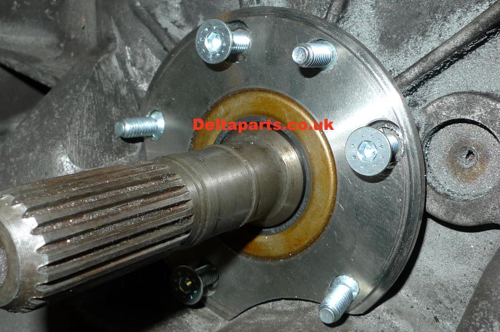

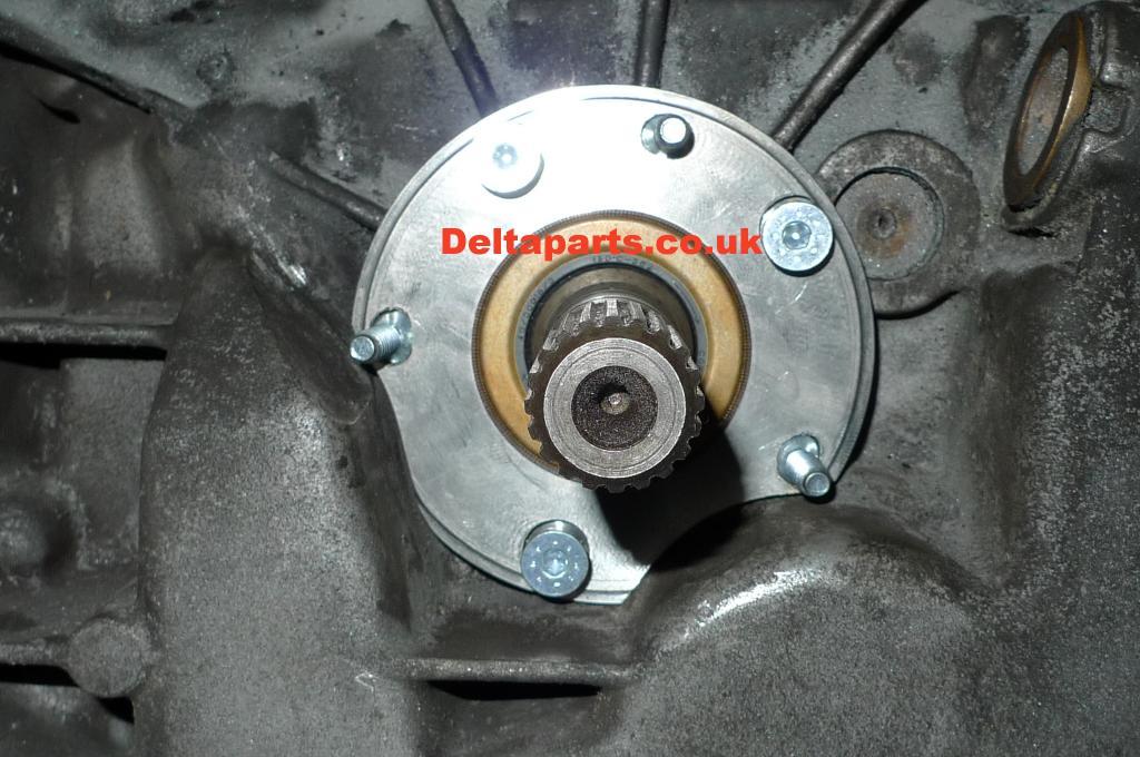

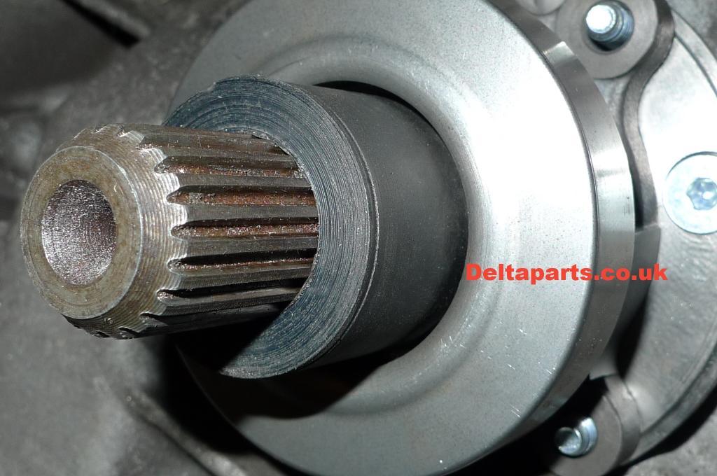

    Użytkownik Maniak resoraków Avatar Suzumushi
    08 2012
    155Q4, 147GTA, Giulietta QV, Giulia Q, Ducati STF V4S
    754
    A few pictures will tell more than thousand words, here you go:

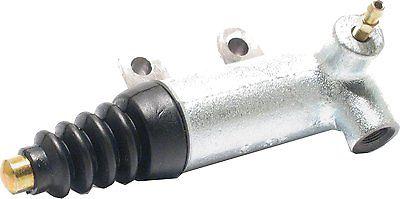

    Suzumushi ,
    thank you for fotos, but i think, its possible use slave cylinder from AR 147 1.9jtdm
    Valeo 804 507
