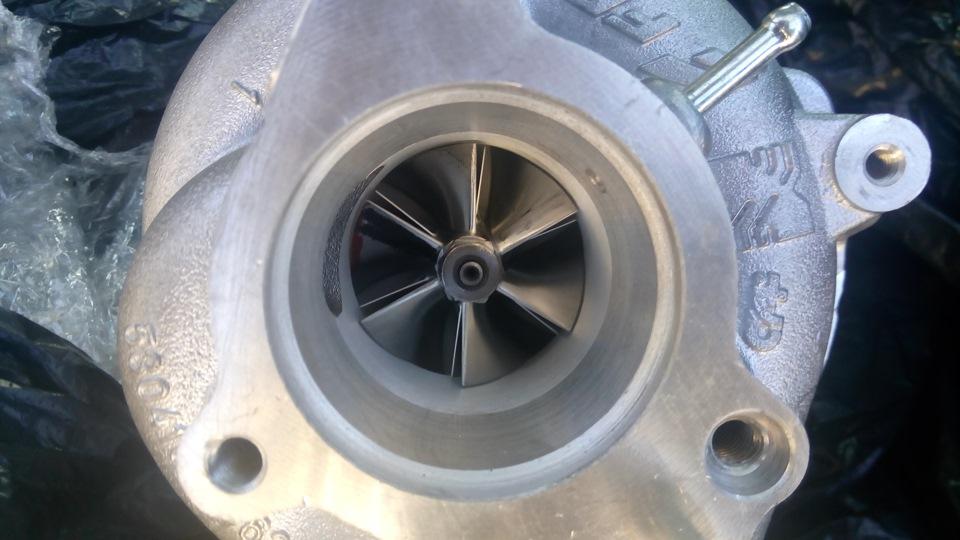

We made good hybrid K03/K04 for my AR159 with 1.75TBi engine.
Billet aluminium compressor wheel. Very nice config ;)!
We will try get 300+ with remap.
You sure? May be in Giulietta QV?
Stock turbo from 159 veeeery small for 300hp.
240-250hp possible...
Its magic?
See the difference. 159 TBi is combined with M32 (torque >440 will kill that gearbox immediately) and smaller turbocharger. Maybe different injectors also?
@acab you need to swap gearbox first :P Depends on desired torque of course.
