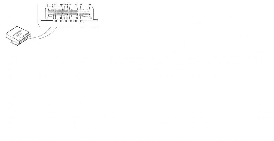

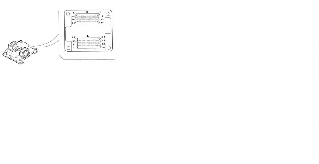

    Panowie potrzebuje opis wtyczki ECU z wersji 3.2V6 i 3.0V6 CF3 , mam eLearma ale za cholerę nie mogę tego znaleźć ktoś poratuje ?
    09 2009
    Bełchatów
    3,286
    Jeśli masz Elearn to podaję ścieżkę:
    Descriptions > 10 ENGINE > 1056 PETROL INJECTION SYSTEM > 1056B multi-point injection system (mpi)
    http://chomikuj.pl/danus77
    Użytkownik Rowerzysta Avatar dawid_007_04
    10 2008
    Tucze
    Była Alfa 155 2,5 TD 1994r. Alfa 166 3.2 V6 , Alfa 166 2,4 JTD 2000 r
    327
    Już sprawdzam
    Bingo !! Dzięki [MENTION=5374]danus77[/MENTION]

    ME2.1
    A-1, N.C.
    A-2, Supply
    A-3, Igntion earth
    A-4, N.C.
    A-5, Lambda sensor heater
    A-6, Relay for 1 st fan speed
    A-7, Ignition earth
    A-8, Electronic earth (for sensors)
    B-1, N.C.
    B-2, N.C.
    B-3, Programming
    B-4, Battery
    from C-1 to C-20, N.C.
    C-21, Fuel vapour recovery solenoid valve
    C-22, Supply for potentiometer - 1 accelerator pedal
    C-23, Earth for potentiometer - 1 accelerator pedal
    C-24, Signal for potentiometer - 1 accelerator pedal
    C-25, Signal for potentiometer - 2 accelerator pedal
    C-26, Earth for potentiometer - 2 accelerator pedal
    C-27, Supply for potentiometer - 2 accelerator pedal
    C-28, Sport throttle response on warning light
    C-29, Fuel pump relay
    C-30, N.C.
    C-31, Lambda sensor earth
    C-32, Lambda sensor signal
    from C-33 to C-37, N.C.
    C-38, Rpm signal
    C-39, Diagnostic connection (line K)
    C-40, N.C.
    D-1, N.C.
    D-2, N.C.
    D-3, Relay for cooling fan 2 nd speed
    D-4, N.C.
    D-5, CAE gear selector switch
    from D-6 to D-10, N.C.
    D-11, CAN line "high"
    D-12, CAN line "low"
    D-13, Speedometer signal
    D-14, Brake lights switch
    from D-15 to D-16, N.C.
    D-17, CAE recognition
    D-18, N.C.
    D-19, Clutch pedal switch
    D-20, Cruise control set +
    D-21, Cruise control set -
    D-22, Cruise control - recall
    D-23, Brake switch
    D-24, Cruise control deactivation
    E-1, Operation of injector for cyl. 3
    E-2, Operation of injector for cyl. 6
    E-3, N.C.
    E-4, Air conditioning compressore relay feed
    from E-5 to E-9, N.C.
    E-10, Cruise control on warning light
    E-11, N.C.
    E-12, N.C.
    E-13, Operation of injector for cyl. 2
    E-14, Operation of injector for cyl. 5
    E-15, Air conditioning pressure switch 1st stage
    E-16, N.C.
    E-17, Air conditioning pressure switch 2nd stage
    from E-18 to E-20, N.C.
    E-21, Air conditioning request switch
    E-22, N.C.
    E-23, Sport throttle response switch
    E-24, Sport throttle response switch earth
    E-25, Operation of injector for cyl. 1
    E-26, Operation of injector for cyl. 4
    E-27, N.C.
    E-28, Coolant temperature sensor earth
    E-29, Coolant temperature sensor signal
    E-30, N.C.
    E-31, Potentiometer - 1 butterfly casing
    E-32, Earth for potentiometer 1-2 butterfly casing
    E-33, Supply for potentiometer 1-2 butterfly casing
    E-34, Potentiometer - 2 butterfly casing
    E-35, N.C.
    E-36, N.C.
    E-37, Rpm sensor (-)
    E-38, Rpm sensor (+)
    E-39 Timing sensor earths
    E-40, Timing sensor signal
    E-41, Earth for detonation sensor 1 (cylinders 1-4-5)
    E-42, Signal for detonation sensor 1
    E-43, Earth for detonation sensor 2 (cylinders 2-3-6)
    E-44, Signal for detonation sensor 2
    E-45, Air temperature sensor
    E-46, Flow meter - reference voltage 5V
    E-47, Output voltage (signal) - flow meter
    E-48, Earth - flow meter
    F-1, Butterfly casing motor integrated with D.V.L. (-)
    F-2, Butterfly casing motor integrated with D.V.L. (+)
    F-3, N.C.
    F-4, N.C.
    F-5, Operation of ignition coil for cyl. 6
    F-6, Operation of ignition coil for cyl. 2
    F-7, N.C.
    F-8, Earth
    from F-9 to F-12, N.C.
    F-13, Operation of ignition coil for cyl. 4
    F-14, N.C.
    F-15, N.C.
    F-16, N.C.
    F-17, Operation of ignition coil for cyl. 3
    F-18, N.C.
    F-19, Operation of ignition coil for cyl. 5
    F-20, Operation of ignition coil for cyl. 1
    F-21, Operation of injection warning light
    ME3.1
    A1, Cruise Control warning light
    A2, Fuel vapour solenoid valve operation
    A3, Alfa Romeo CODE connection
    A4, Not connected
    A5, Gear selector (auto. trans. only)
    A6, Compressor engagement request
    A7, Power supply for accelerator pedal potentiometer
    A8, Signal for potentiometer - 1 accelerator pedal
    A9, Quadrinary - Fan 1st speed request
    A10, Cruise Control ON/OFF
    A11, Automatic transmission version code
    A12, CAN-L line
    A13, Compressor relay control
    A14, Not connected
    A15, Direct supply
    A16, Supply controlled by ignition, via main relay
    A17, Not connected
    A18, Cruise Control warning light
    A19, Engine coolant overheating warning light
    A20, Preparation for Flash Programming
    A21, Not connected
    A22, Fuel level sensor
    A23, Not connected
    A24, Earth for potentiometer - 1 accelerator pedal
    A25, Earth for potentiometer - 2 accelerator pedal
    A26, Brake lights switch
    A27, Brake lights switch
    A28, SPORT function switch
    A29, CAN-H line
    A31, Fuel pump relay feed
    A31, Main relay activation
    A32, Supply controlled by ignition, via main relay
    A33, Not connected
    A34, SPORT function warning light
    A35, Rev counter signal
    A36, Not connected
    A37, Not connected
    A38, Signal from air conditioner
    A39, Not connected
    A40, Signal for potentiometer - 2 accelerator pedal
    A41, Quadrinary - fan 2nd speed request
    A42, Cruise Control Resume
    A43, Cruise Control SET +
    A44, Speedometer sensor signal
    A45, CAN-H line
    A46, Injection warning light
    A47, Supply controlled by ignition
    A48, Supply controlled by ignition, via main relay
    A49, Not connected
    A50, Operation of fan 1st speed
    A51, Not connected
    A52, Fuel consumption signal
    A53, Diagnostic connection (K line)
    A54, Air temperature sensor signal
    A55, Not connected
    A56, Supply for accelerator pedal potentiometer
    A57, Air flow meter signal
    A58, Cruise Control SET -
    A59, Clutch pedal switch
    A60, Oil pressure switch
    A61, CAN-L line
    A62, Operation of fan 2nd speed
    A63, Air flow meter supply
    A64, Not connected
    B1, Throttle body motor earth
    B2, Lambda sensor heating (pre-cat. 2) (front bank)
    B3, Operation of injector for cyl. 2
    B4, Not connected
    B5, Not connected
    B6, Detonation sensor 2 reference earth
    B7, Lambda sensor earth (pre-cat. 2)
    B8, Not connected
    B9, Not connected
    B10, Engine rpm sensor
    B11, Not connected
    B12, Lambda sensor earth (post-cat. 2)
    B13, Not connected
    B14, Cylinder 3 coil operation
    B15, Cylinder 2 coil operation
    B16, Cylinder 1 coil operation
    B17, Throttle body motor supply
    B18, Lambda sensor heater (post-cat. 2)
    B19, Operation of injector for cyl. 1
    B20, Operation of injector for cyl. 3
    B21, Not connected
    B22, Detonation sensor 1
    B23, Lambda sensor signal (pre-cat. 1) (rear bank)
    B24, Potentiometer - 1 throttle body
    B25, Engine coolant temperature
    B26, Sensors reference earth
    B27, Not connected
    B28, Lambda sensor signal (post-cat. 1)
    B29, Not connected
    B30, Cylinder 6 coil operation
    B31, Cylinder 5 coil operation
    B32, Cylinder 4 coil operation
    B33, Throttle body motor earth
    B34, Lambda sensor heater (pre-cat. 1)
    B35, Operation of injector for cyl. 4
    B36, Operation of injector for cyl. 6
    B37, Operation of EGR solenoid valve (preparation)
    B38, Detonation sensor 2
    B39, Lambda sensor signal (pre-cat. 2) (front bank)
    B40, Potentiometer 2 throttle body
    B41, Not connected
    B42, Timing sensor signal
    B43, Not connected
    B44, Lambda sensor signal (post-cat. 2)
    B45, Not connected
    B46, Not connected
    B47, Not connected
    B48, Not connected
    B49, Throttle body motor supply
    B50, Lambda sensor heater (post-cat. 1)
    B51, Not connected
    B52, Operation of injector for cyl. 5
    B53, Not connected
    B54, Detonation sensor 1 reference earth
    B55, Lambda sensor earth (pre-cat. 1)
    B56, Not connected
    B57, Not connected
    B58, Throttle body potentiometers supply
    B59, Engine rpm sensor
    B60, Lambda sensor earth (post-cat. 1)
    B62, Not connected
    B63, Not connected
    B64, Not connected
