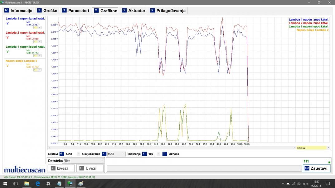

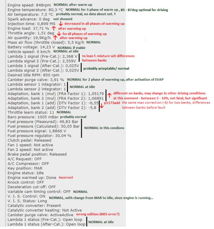

    [lang=en]Below are the reading from today. Warmed up and idle. And the lambda sensor idle, and rewing (PICTURE).
    Can you tell me which data do you need. Which program do I use for messure Fuel Trims??
    And, do you have correcz values for tihis engine.
    I'W NOTICED THAT VARIABLE INLET GEOMETRY (WHEN DRIVING) IS ALWAYS LONG (NOT SWITCHING), AND VARIATOR IS ALWAYS OFF, NOT ACTIVATED DURING DRIVING. WHY? I MEAN THIS COULD BE A PROBLEM WITH NO POWER.
    Engine load is still high.Kliknij obrazek, aby uzyskać większą wersję

    - static compression is low on all cylinders…
    - fatal position of TP…
    - on diagram:
    ---- idle: significant differences between lambda pre-cat signals on banks
    ---- acceleration: no significant differences between lambda pre-cat signals on banks, probably correct values of lambda (or slightly increased, rich). Thus, p1173multi (or high positive LTFT) is not excluded.
    - ECU can increase or decrease the torque depending on the engine's operating conditions and the signals from the sensors. ECU controls and activates phase variator and probably VIS under specific conditions.
    - To adjust the phase variator and probably VIS, ECU requires information about rpm, engine load and ECT and the positions of the crankshaft and camshaft (in JTS only for calculation of GMP for each cylinder). From oscilloscope: probably for power, exhaust valves are opened late. Inlet valves open after TDC and close after BDC. And so, ECU can activate phase variator earlier, at lower rpm than 2850 rpm. It can also activate VIS typical above 5000 rpms, but ie for a very short time.
    - signals from crankshaft and camshaft are probably correct. Bad signal from this sensors can cause specific faults in ECU and no adaptation (no FT evolution) and/ or problems with engine start. In your car adaptation is present, but with fault of mixture strength and engine is running….
    - High rpm and low load may cause no VIS activation and sometime no detection of misfire by ECU.
    - Low (medium) rpm and low load may cause no phase variator activation.
    Signals from these actuators at idle are correct and engine is running!! No problems with start of engine… it may suggest that the ECU is working correct.
    - To achieve maximum torque, a high degree of volumetric efficiency (VE) must be attained. What is VE in your JTS?
    - These systems are mechanically controlled by intake manifold pressure (VIS) and oil pressure (phase variator). Oil pressure is very important for correct operation of the phase variator at low (medium) rpm.
    - Usually, we perform full OBD test additionally with 3 min of examination of idle before and after driving in various conditions (engine operating states). Its important for comparisons of parameters before and after.

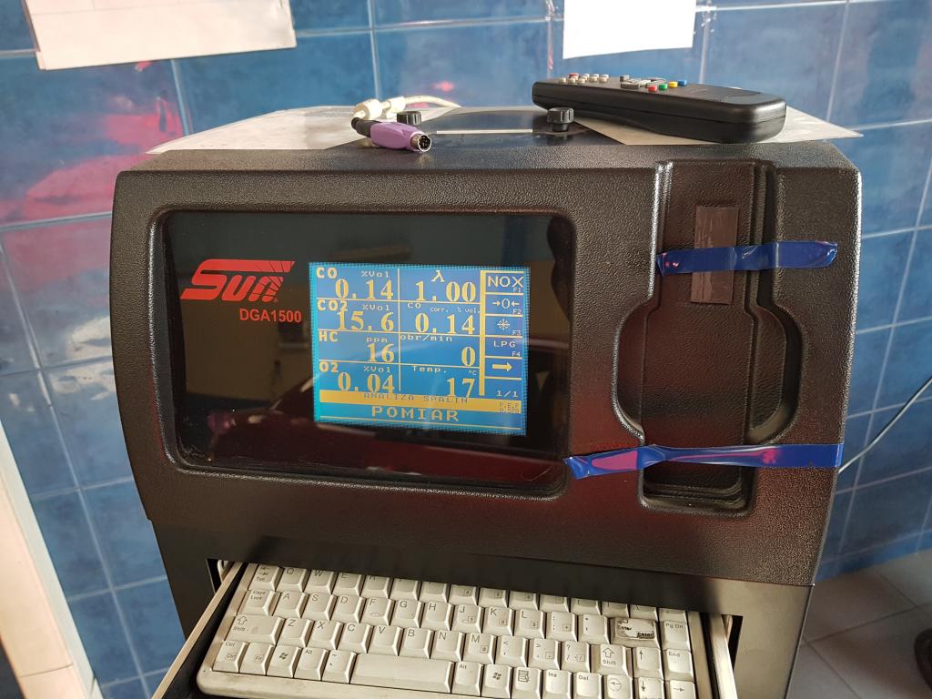

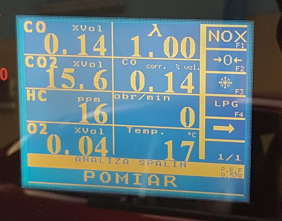

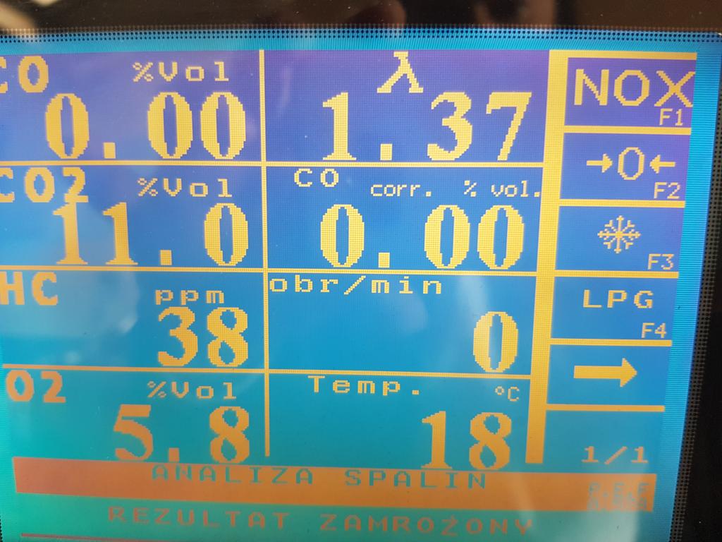

    Test spalin po ponad 16 kkm od odbioru samochodu z naprawy głównej silnika. Zdjęcia, bo nie działała klawiatura i nie diagnosta nie mógł zrobić wydruku. Katalizatory wymienione na nowe w czasie naprawy głównej silnika, zamienniki metalowe, euro4.
    - po 1 naprawie w Łodzi i przed naprawą u Darka, było 600 – 1200 HC w spalinach, mimo trzymania lambda i mimo tego, że katalizatory były obecne. Gdzieś tu są te testy wrzucone. Jest teraz norma.
