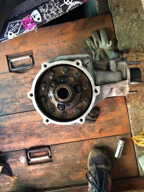

    W takim razie czy ktoś wie jakie przełożenie ma tylny dyfer z Crosswagona?

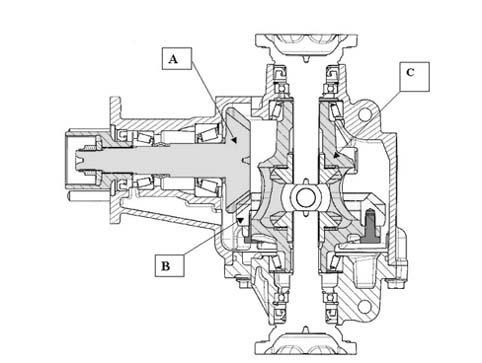

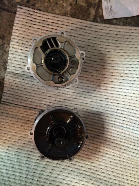

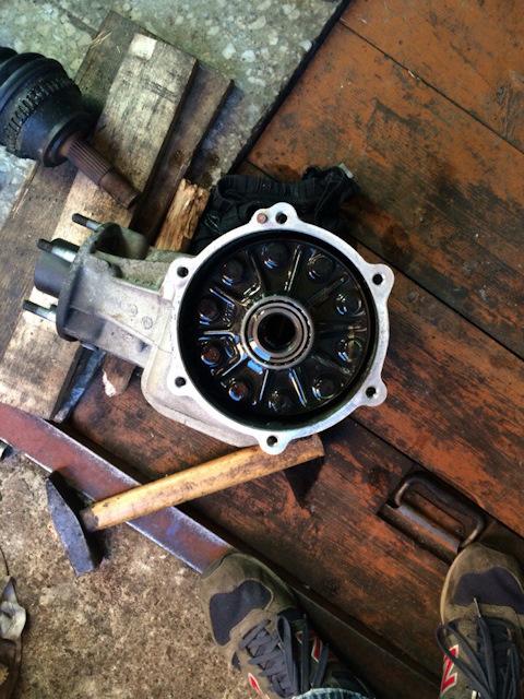

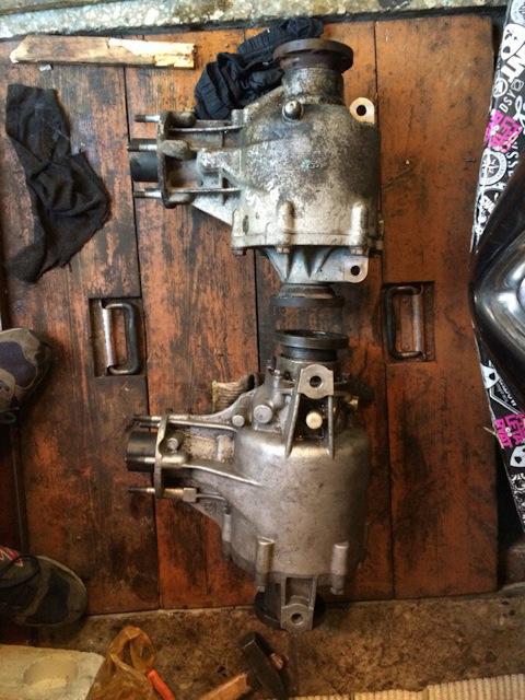

    Rear diff from CrossWagon little smaller but same like from Lancia Delta Integrale
    Difference of diff covers, only axle size:
    Lancia delta diff:
    CrossWagon diff:

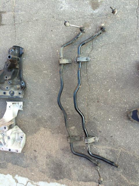

    New antirollbars? From GTA?
  6. #196

    Cytat Napisał koskar Zobacz post
    From CrossWagon

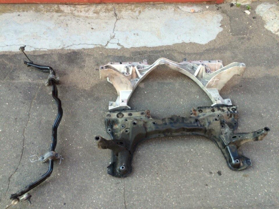

    Stiffer than from standard GT?

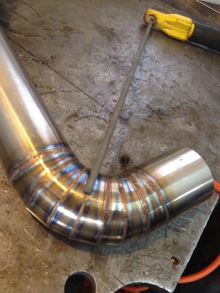

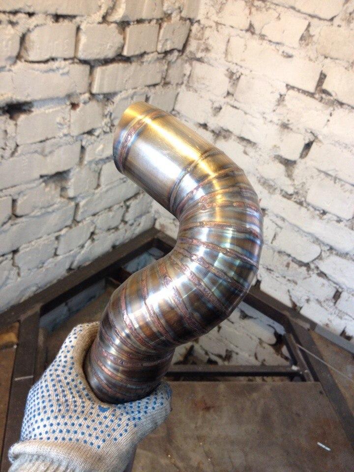

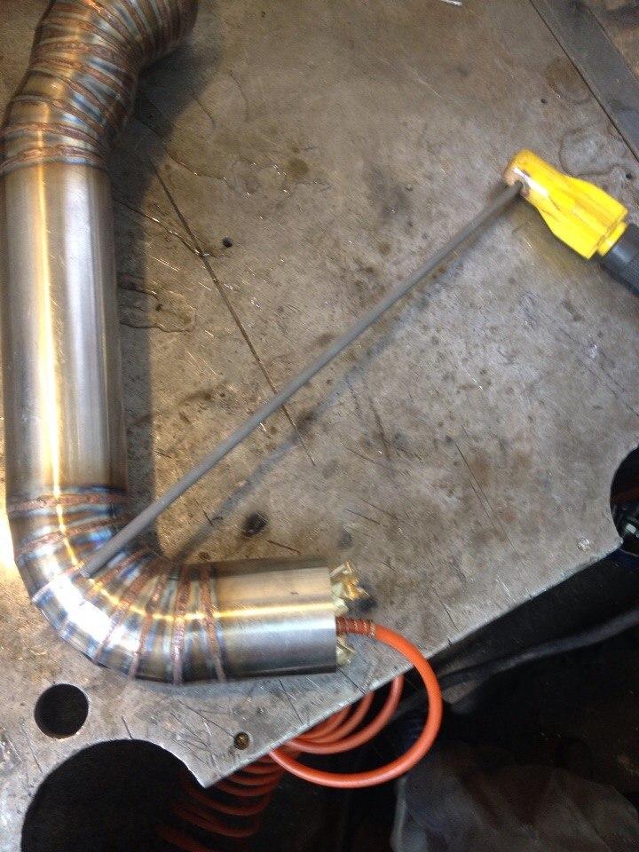

    New downpipe, becouse Q4
